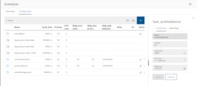

So here is the solution how we solved the issue.
We needed to change the Profinet App from running on core 2, to core 3
That was changed in scheduler ( see Picture below)
With that, all errors had been solved and system is running like desired.
