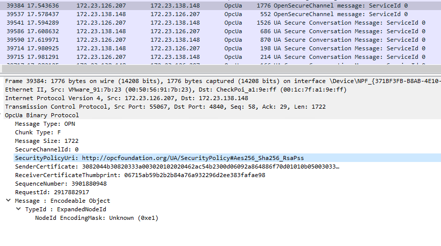

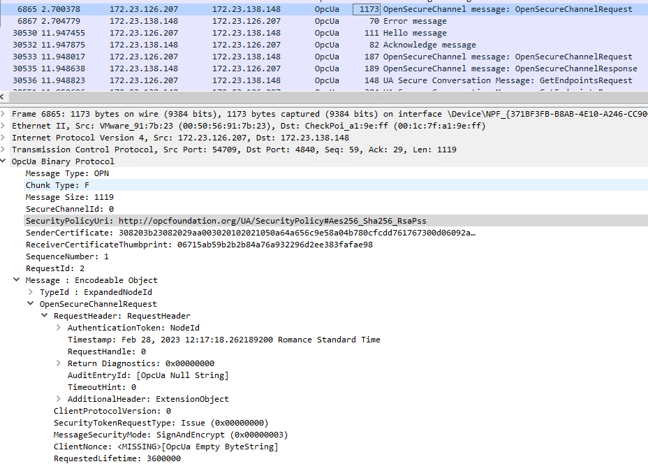

We have looked at the connections with Wireshark from the server and I don't understand why the connection is refused.
Attached are the Wireshark data the OPC UA Expert and MES client. Also the certificates.

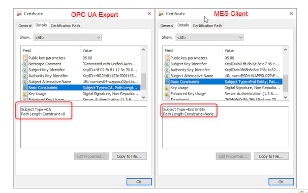

One of the differences I see between certificates is the Basic Constraints. I don't know if this can affect it.
I am not an expert on these certificate and security issues. Do you see any problem in the client certificate that is incompatible with the OPC UA Server of CtrlX Core?

When you connecting with UA Expert I expect, that you use the same security settings.
Therefore I expect the problem on Opc UA client side (check docu of the client).
I once had problems with establishing a connection with WebIQ UA client, and couldn't find a missconfiguration. At the end I delete the configuration and created it new, and than it worked.
I don't think that the problem is on OpcUA server side, but as I mentioned you can try version 1.18 and check the OpcUA diagnostic on datalayer.
