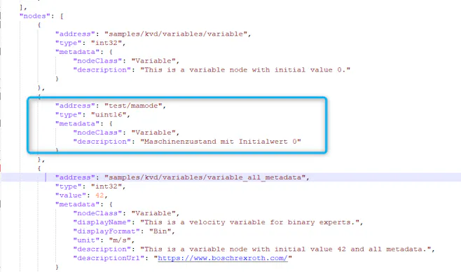

The OPC UA structure + variable "mamode" have been created within the KVD nodes.json
objects/Datalayer/test/mamode

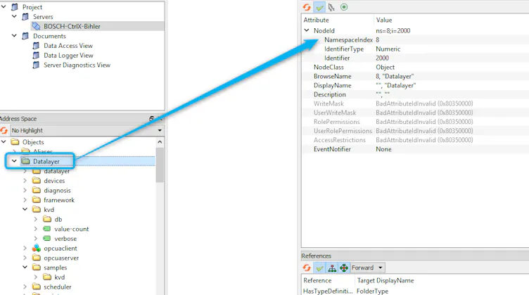

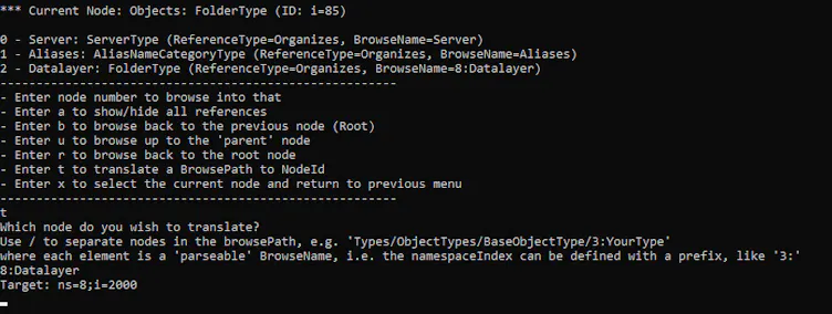

Starting from the root folder browsing and translation the path for 0bjects/8:Datalayer succeeds.
(Therefore a small piece of software of the OPC UA toolkit is used)
As a result the target ns=8, i=2000 is shown.

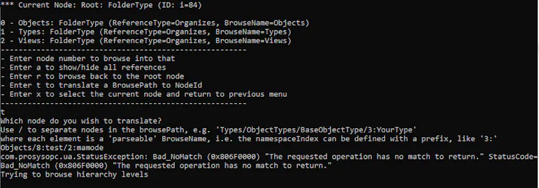

But if we try to translate the path created within the KVD configuration (Objects/Datalayer/test/mamode) to retrieve the NodeId of this path the command fails with an error message provided by the OPC UA server within the CtrlX core.
The error message: StatusCode=Bad_NoMatch (0x806F0000) "The requested operation has no match to return." is shown for every folder/structure except of Objects/8:Datalayer.

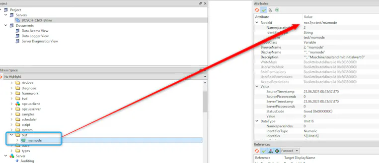

Spelling and NamespaceIndex are correct and have been verified several times. But it seems that something goes wrong underneath the DataLayer which avoids a correct execution/translation using the "TranslateBrowsePathToNodeIds".

Hello Markus,
we have a bug in our implementation of the service "TranslateBrowsePathToNodeIds", therefore it's actual not working for variables. A bugfix is currently not prioritized.
Do you need this function for your certain/actual project?
