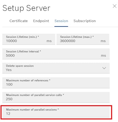

The maximum number of simultaneous sessions can be set in the OPC-UA server configuration.
However, we may have multiple users connecting simultaneously and some of these may open more sessions than expected.
Is it possible to set the maximum number of sessions for a single user?
Best reply by NoRisk4Project
this is a general setting for the server and not a user dependent setting. Therefore it's not possible to limit the max. number of sessions for a single user.
Do you have a special use case in mind or do you have a problem with a certain application/OPC UA client?
