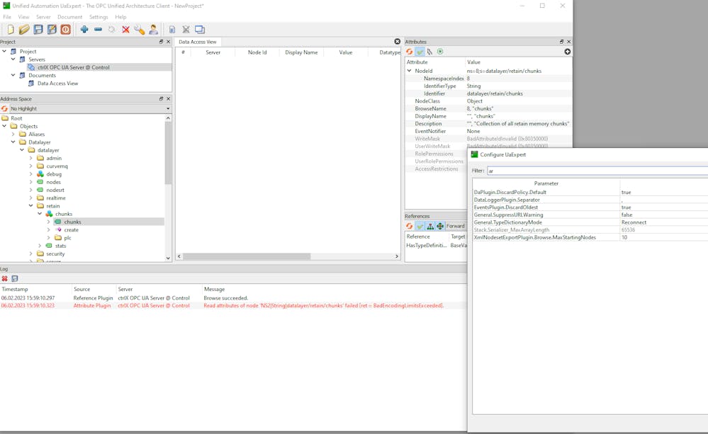

The Reason for the error “BadEncodingLimitsExceeded” (“FT-Optix.png”) inside the FT Optix OPC UA client is the variable “ns=2;s=datalayer/retain/chunks”. The client tries to read the value and fails, because of the size of the returned data.

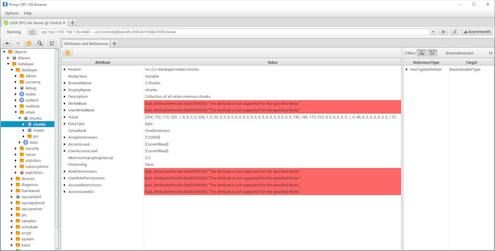

We also teted other clients like e.g. the Prosys OPC UA client can read the value and here you see it’s an array with 122880 elements:
read value in Prosys OPC UA client
The UA-Expert can read, but cannot show the value, because the default setting for the array size is 65536:
read value in UA_Expert OPC UA client
After increasing the max array size to 123000 the UA-Expert is able to show the data too:
read value in UA_Expert OPC UA client 2

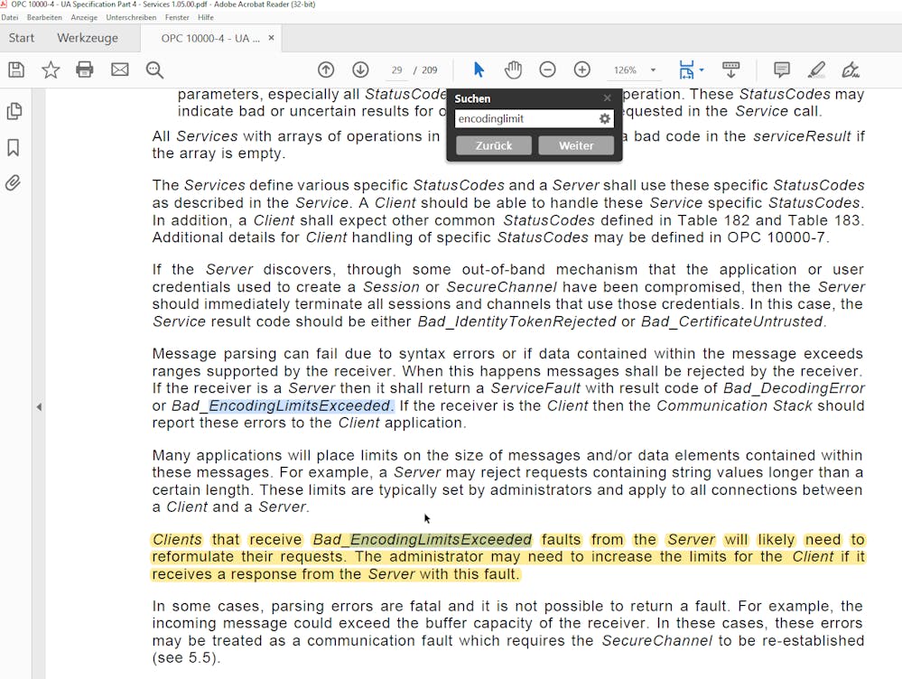

And this fits to the OPC UA specification:
OPC UA specification BadEncodingLimitsExceeded

The client must handle such “BadEncodingLimitsExceeded” errors. Please check if you can increase the max array size inside the settings of the FT-Optix UA Client.
