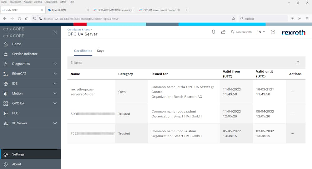

I've install OPC-UA server, server is running status and user permissions are set and license is installed. But I still recieve no endpoint.
VPN is disabled/closed.
Wired connection 1:1 with DRIVE XF10.
Attached some information of setup (I've included the diag to show the current error is regarding only 24V available and nothing to do with OPC-UA)
help?
ctrlX COREs OPC UA server is using encryption and authentication.
  • Did you choose the correct security protocol?
  • Did you insert the correct user name and password?
  • Did already trust the certificate of the client in your server settings?
    ctrlX CORE WebUi OPC UA certificates
