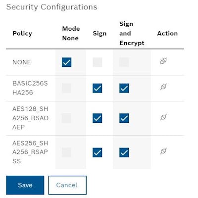

Hi have a customer who is trying to access the ctrlx opc-ua server in anonymous mode. opc-ua server 1.12. Even if i have activated the "deprecated options" and activate the right policies from the front-end seems like the server is still asking for a login and password info. Is it normal?ย
here my security conf

Anonymous mode is not supported. You configured a none secure communication. In this case the password will be not encrypted, so anyone is able to see the password plaintext and we absolutely don't recommend that. Nevertheless the ctrlX OPC UA Server requires always a username and password, which is configured in ctrlX identity manager. See also here: https://docs.automation.boschrexroth.com/document/version/03/OPC-UA-Server-App_-Application-Manual/chapter/metadata.boschrexroth.de~iiDC~Topic-199a508d5a5133a30a347e88473f62ae-2-en-US~en/
