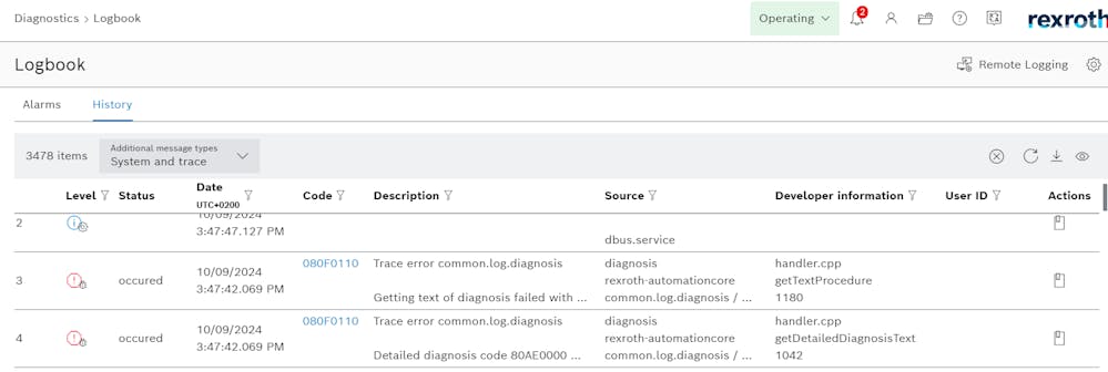

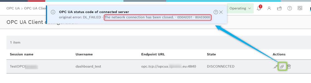

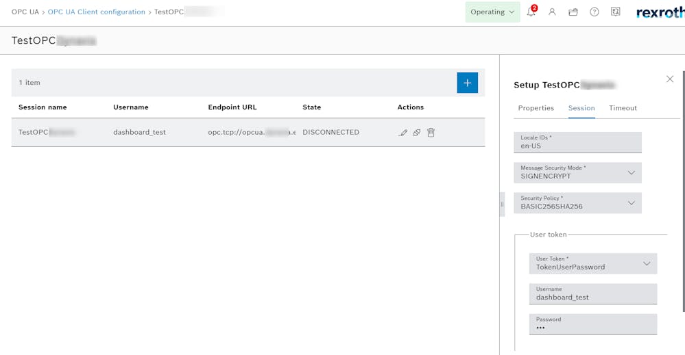

Our customer is struggling in performing OPC-UA communication between a CtrlX Core as client and a remote CtrlX Core as server. 'Remote' means server can be accessed on a different remote network by internet.

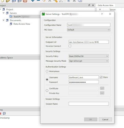

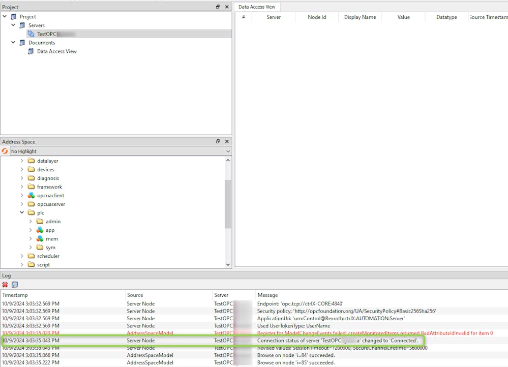

The use of UA Expert leads to a successful communication whereas unsuccessful with CtrlX Core Client.
Unfortunately there is no accurate info regarding this error code.

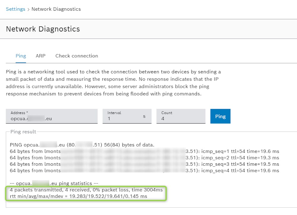

However connection to remote Ip is successful:
