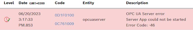

i'm getting the following error. any idea on what could be the issue?
Error code -46 indicates a invalid configuration of the OPC UA Server App. I forwarded the configuration file of your app to the development team of the OPC UA Server App and will let you know, when I got feedback from them.Â

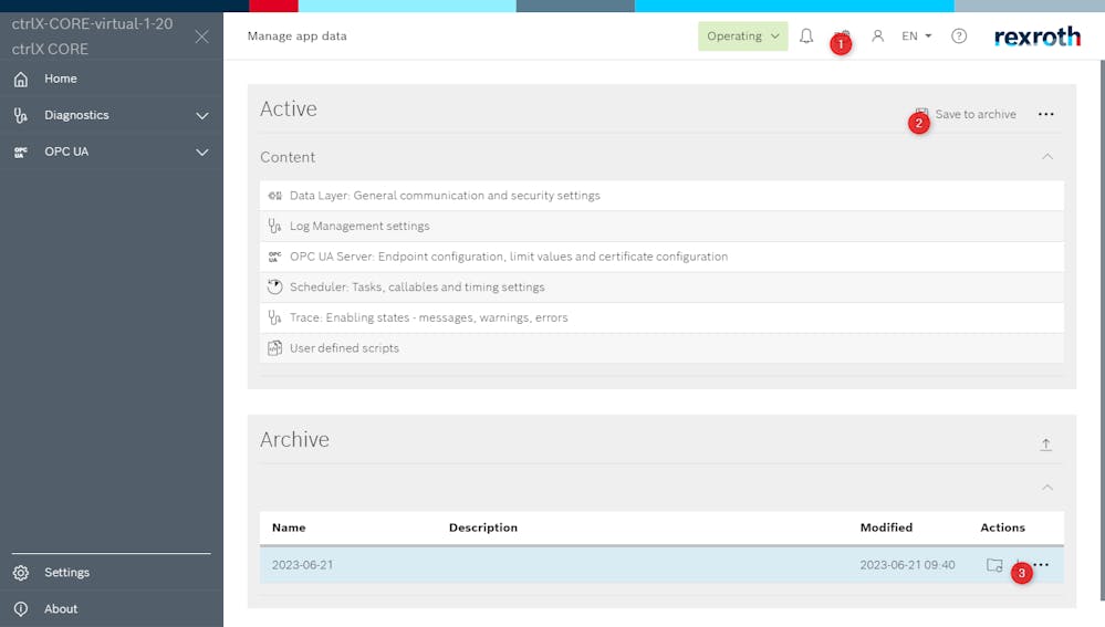

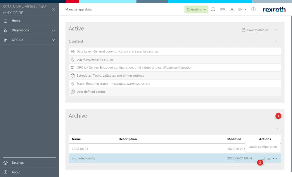

In the meanwhile, I would recommend you to delete the configuration of the OPC UA Server and reboot the ctrlX CORE and check if the error is not longer present. You can do that by creating a .zip archive of the configuration files. Download these files, unzip the archive, delete the folder "opcuaserver". Afterwards zip the folder again and upload it. Then you set this configuration to active.Â
