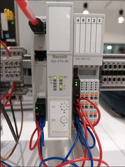

I am using S20-ETH-BK and S20-DIDO-8/1,

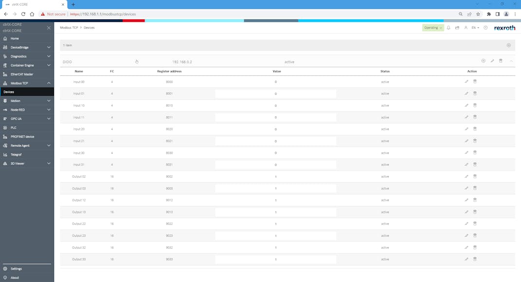

I am testing ctrlX Modbus TCP App to write to digital output, but however the digital output LED indicator did not light up.
Below is my setup.
Plug & play is disabled.
Designation "D" is flashing green -
ctrlX Modbus TCP App setup
I am unsure if it is because my S20-DIDO-8/1 designation "D" is flashing green or my setup is incorrect.

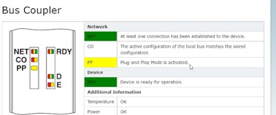

Does the diagnosis of the S20-ETH-BK in the direct web browser view show something (bus coupler or local bus)?
What is the state of the the BK, like Plug & Play active)?
Is a process data watchdog configured?
We can take a look together, send a PN how I can contact you.
