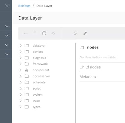

after a certain period of time the data structure which is part of the KVD app disappeared / is missing in the CtrlX data layer.

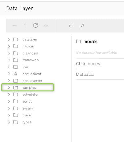

e.g. by default the samples\kvd is configured for the user directories.
After a few days this structure just disappeared and all the functions which refer to this structure run into an error.

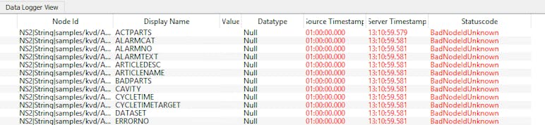

1) UA Expert => BadNodeIdUnknown (path: samples/kvd/...)
2) Data Layer => no such path available anymore
After restarting the CtrlX core the folder is available again:
To guarantee a reliable functionality we have to ensure that the folder is not missing otherwise no data will be received by the OPC-UA communication. (data is provided by the KVD app which exactly provides this folder)
