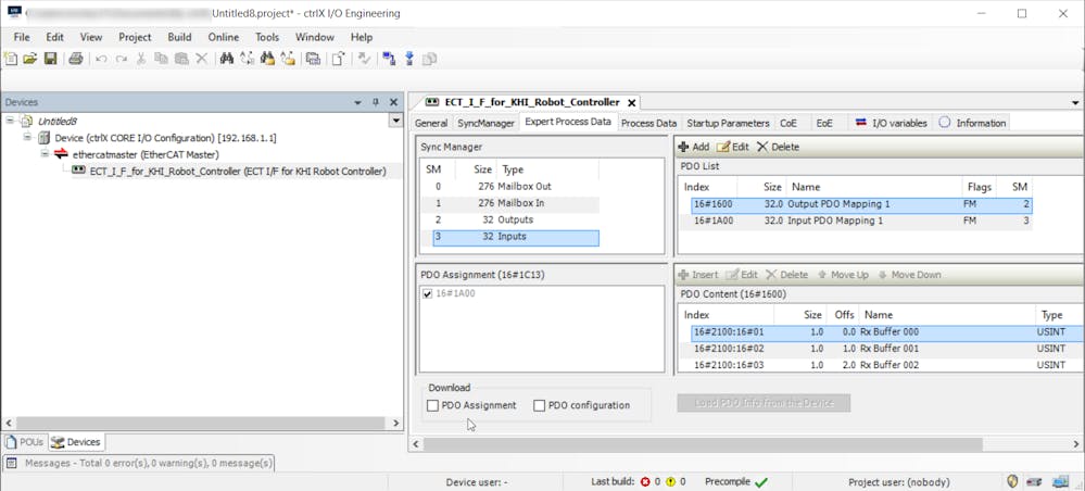

Could you please check is the tick on the expert process data page for overwriting the PDO assignment is set? I inserted it in a project on my side and in standard it isn't:
ctrlX IO Engineering - Expert process data
Also check if something in the startup parameter, that is not in standard.
You also add your project to this topic or send it in a private message to me, so I can have a look to it.
Some vendors are using a special mechanism that generates the PDO assignment while running and it needs to be imported by the configuration tool out of the IO. This feature is currently not supported by ctrlX IO Engineering. Please check the documentation of the supplier.
