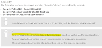

In the OPC UA Server App Manual It states that it is possible to set the SecurityPolicy to None, and it can be configured in the datalayer.

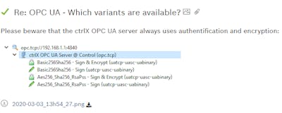

However, a post made a while back states that the server will always use an auth/encryption.

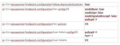

it is possible to configure the ctrlX OPC UA Server with none Secure Endpoints.
The settings can be done via Datalayer or OPC UA. For that you need a configuration like that:
Then you need to restart the opc ua server.
