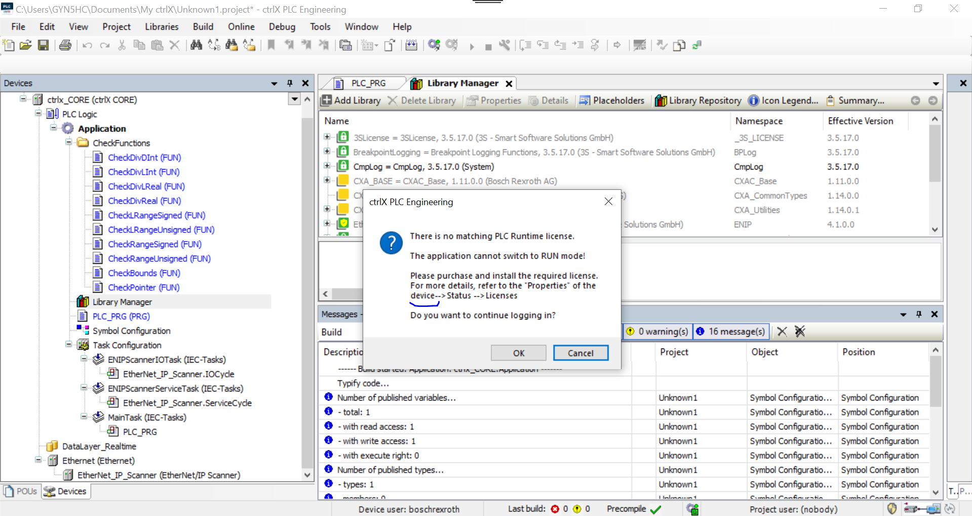

I have installed license for Ethernet/IP scaner for ctrlX core.
How ever, when I add the node Ethernet/IP in PLC then I cant download because it informed me there is no license! (See attached picture)
Do you know this problem? please share with me.
Thank you!
Which PLC app licenses do you have on your ctrlX CORE? As you are using 3 Tasks you will at least need PLC Basic and PLC Standard. See store page "ctrlX CORE - PLC App":
