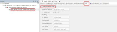

Can you please check in ctrlX IO engineering whether the EOE is activated. In some cases the EOE can cause very high traffic at the beginning. This should be fixed soon.
