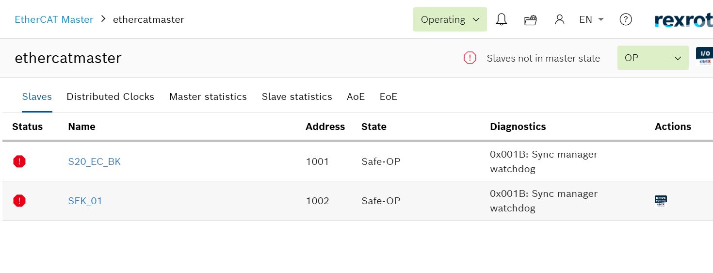

We have X3 PLC with S20-EC-BK and Smart Function Kit for Pressing, with Ethercat communication. I want to implement an error detection on bus, and I'm trying to use CXA_S20 library for it. Issue is, when I unplug S20's connection to PLC, its state changes to error "0x0001B: Sync Manager Watchdog" and stays that way even if I plug the cable back, until we reset the system.
Do you have any ideas how to detect or reset that?ย
