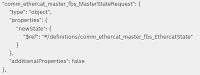

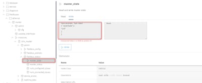

Firstly I try to do it directly from the datalayer (JSON) but I don't find the right syntaxe.

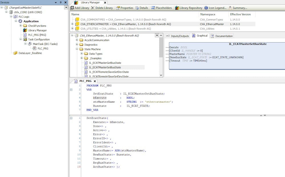

Best reply by TheCodeCaptain
Hi Franck_FR,
from the PLC you can take the function block "IL_ECATMasterSetBusState" from the library "CXA_ETHERCATMASTER".
See screenshot or example project:
ChangeEcatMasterStatePLC.zip
165.35KB
