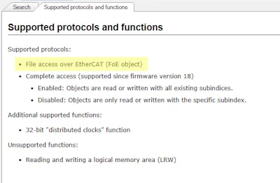

Hello
Can we use FOE protocol with ctrlX?
For B&R device FOE protocol support is required.
Thanks and Regards
SAM
Yes, FoE is supported. Please have a look to the official documentation of our ctrlX CORE - EtherCat master app for all features.
