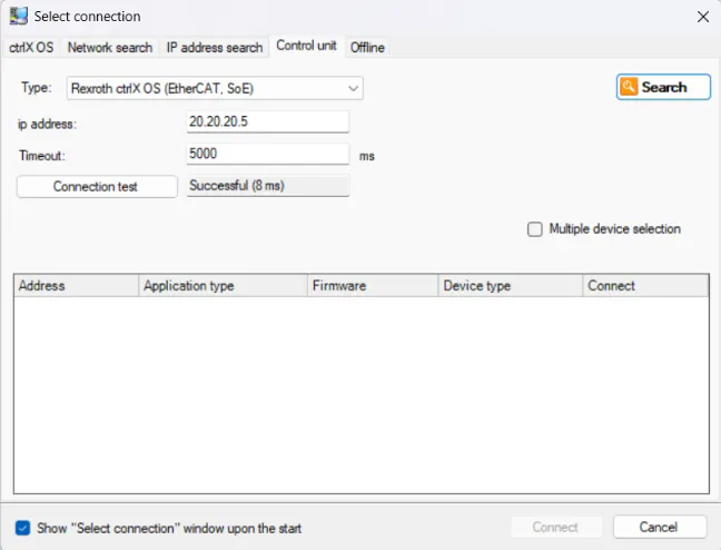

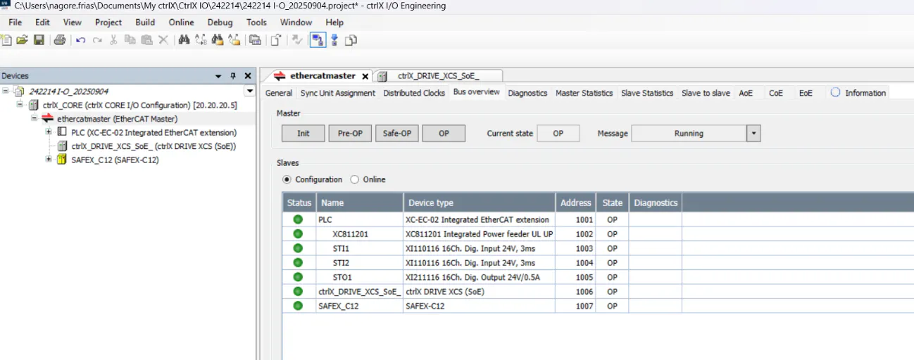

A customer has a ctrlX DRIVE communication through EtherCAT with a ctrlX CORE.
Connection with ctrlX DRIVE Engineering via ctrlX CORE is not working, why could be that?
Here I show you some screenshots:
Every slave is in OP:

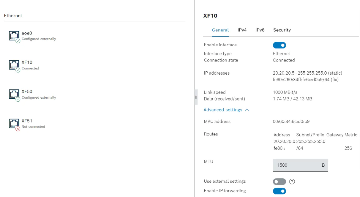

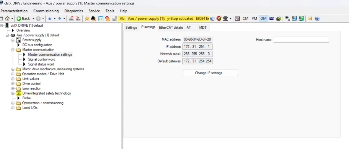

ctrlX DRIVE IP settings:
Communication with the ctrlX DRIVE is made through the panel USB.

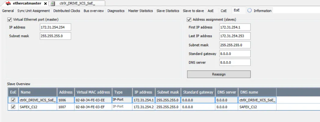

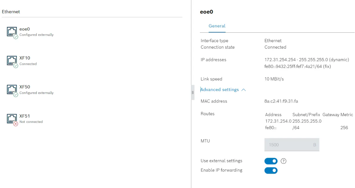

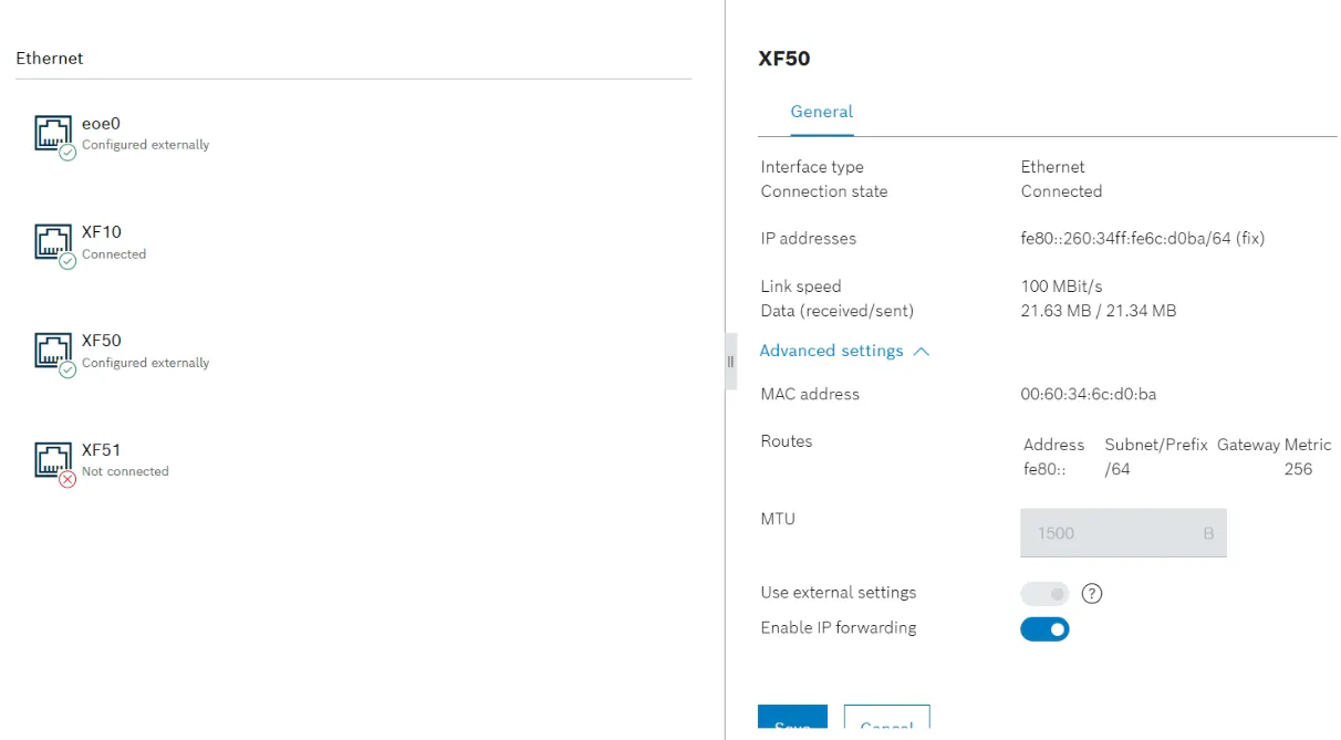

Even with EoE and IP-forwarding activated, there is no communication:
EoE configuration:
Ethernet ports configuration:
