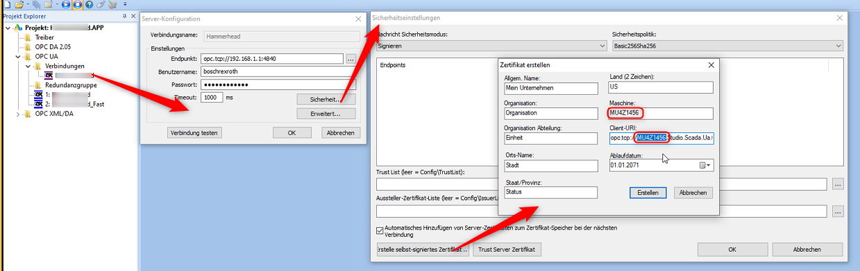

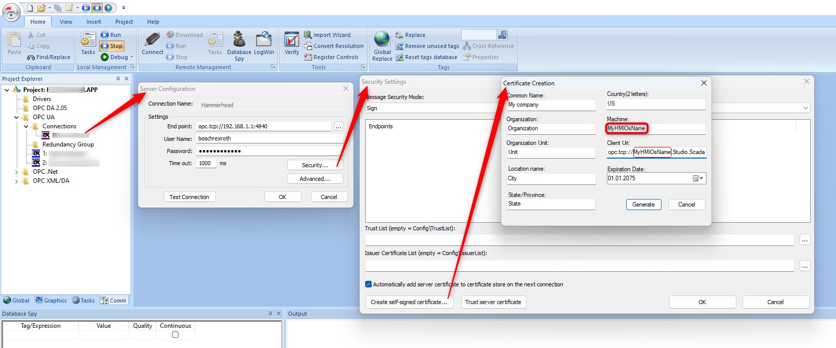

Please check the system clocks from your ctrlX CORE and your HMI or engineering PC. They have to be the same for correct security checks.
Also with WinStudio included in IW 15V10 is still a bug in the certification tool. You would need the actual IW15V12 with WinStudio runtime 7.4 SP2 on the HMI PC.
At last please beware that the name of the HMI PC has to be insert in the certificatehttps://files-eu-central-1.t-cdn.net/files/ylAZntDngAQuiUhTicFQm .
WinStudio - certificate setting
