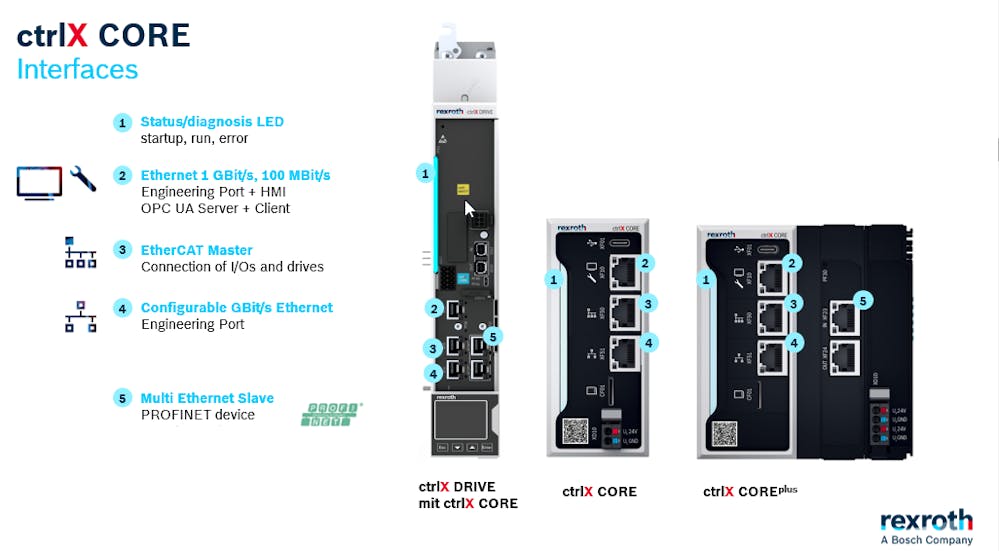

Can we use XF23 or XF24 from the multiethernet extension as EINP adapter orScanner using these Codesys apps: R911411682 - SWL-W-XC*-COSY*ENIP*ADP**-NNNN , R911411680 - SWL-W-XC*-COSY*ENIP*SCN**-NNNN ?
Thank you,
Â
Regards
Thank you,
Â
Regards
At the moment these ports are for ProfiNet slave only and useable in combination with our ctrlX CORE - Modbus TCP App.
