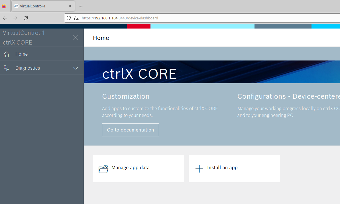

I have a Linux host and a Windows 10 Guest (using VirtualBox). Inside the Guest I succesfully installed ctrlx Works, PLC, etc. I added a VirtualControl (ctrlx COREvirtual) and it is online, including port forwarding, also to external. I disabled the firewall on my Guest.
From my (Linux) host, I am able to browse to the VirtualControl, using the IP from my Guest: LINK . See screenshot attached.
