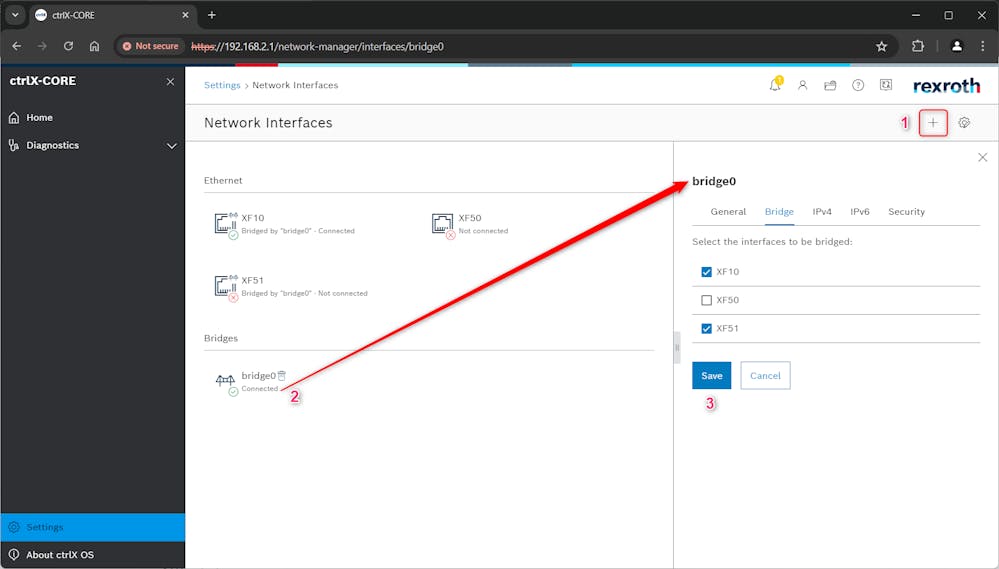

Sometimes we have a situation where we connect several devices to a switch. A number of times we already used all the available ports and we were only one port short, resulting in an extra switch. To solve this issue I would like to know if it would be possible to configure the XF51 port so that it would be possible to have communication between the laptop and the HMI in the image below.
Thanks to a hint of TheCodeCaptain. In the current version 2.6 it is possible to add a bridge to the ports XF10 and XF51 to act as the same port. Switch of security if asked and beware that IP address changes to 192.168.2.1:
ctrlX web UI - add network bridge
