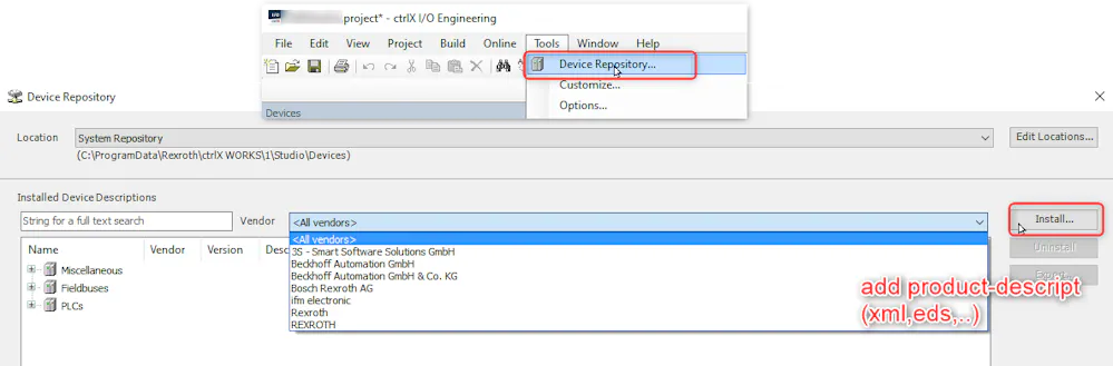

please add the Beckhoff-io-electronic-data-files to the ctrlX_IOEng repository.
In case you ethercat-scan - the devices will be recognized immeditatly.
But keep in mind, that we do not test every available 3rd-party IO with our device.
