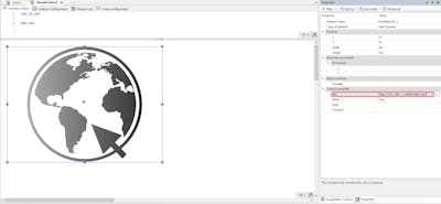

I'm trying to use a video through the WebBrowser in Webvisu but it doesn't work. The configure of  WebBrowser is this:

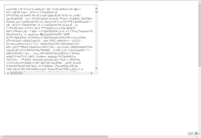

When I run the PLC, the result is this:
Also I try different extensions of videos like .mov, .avi, .webm, .html... but it doesn't work.

You'll need to display the video in an html video element within the WebBrowser control. So rather than specifying the URL of the mp4 in the WebBrowser control, you'll give the URL of an html file that contains a video element targeting your mp4.
For example,
WebBrowser Control URL: : 'http://localhost:18080/VideoTest/playVideo.html'
