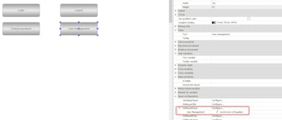

I create four buttons for Login, Logout, Change Password and Manage Users. All of these except the Manage Users work, but in the build doesn't appear any error. When you press the button nothing happens, it's like it wasn't configured.
I put the configuration of the button "Manage Users".

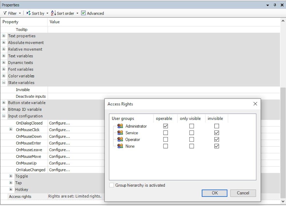

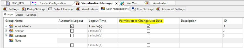

In your visualization manager, make sure that "Permission to Change User Data" is selected for the required users. If it is not, the dialog will not open.
In the user management button properties, you may want to set access rights to make this more obvious to the user.
