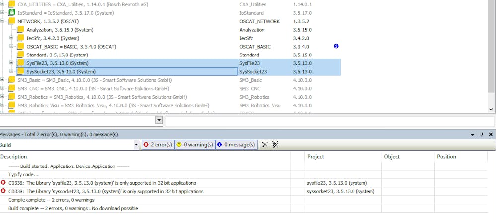

We need to use the Network Oscat library and the problem is that with our current library version it comes up an error as the image shows below:
We have tried with a 32 bit PLC Application and it worked, so we assume that it is because the ctrlX Core is based on a 64 bit architecture,

ctrlX CORE is based on 64 bit operating system, yes.
The actual version of OSCAT available seems to be 1.10 and you are using 1.3 did you try to use the latest version?
