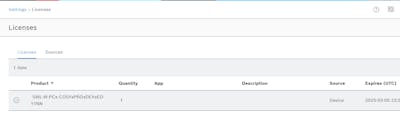

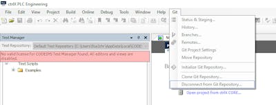

Hello, I have purchased and loaded the PLC developer licesne but my ctrlx PLC installation is still not recognizing it. Is there something more I need to do?Â

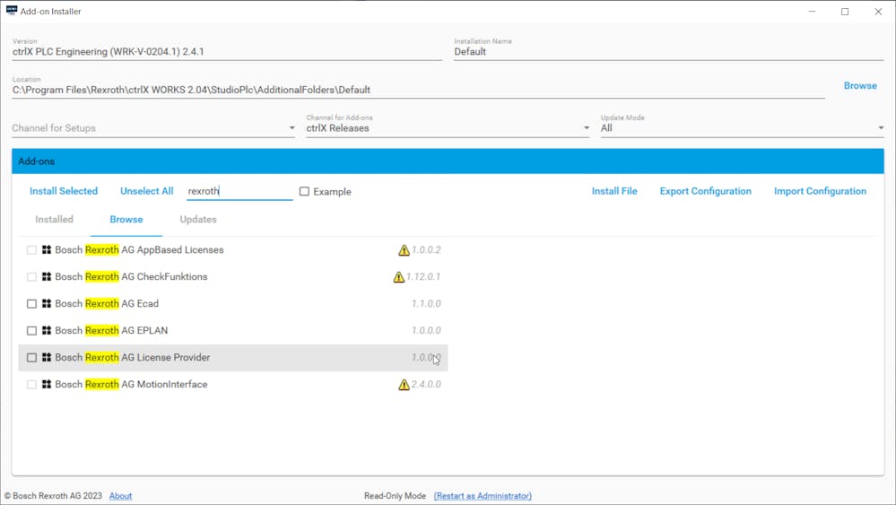

Did you buy the one from the Rexroth store? Then you need to do the same thing like with a ctrlX CORE but your PC. See FAQ for ctrlX WORKS.
Afterwards you have to install the Bosch Rexroth AG License Provider to the ctrlX PLC Engineering via the Add-on installer:
For general information see Quick Start Guide Licensing.
