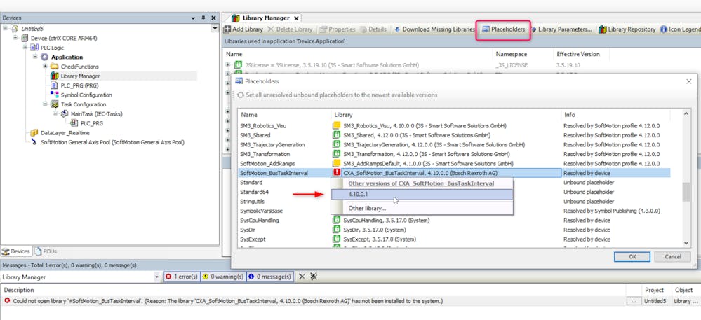

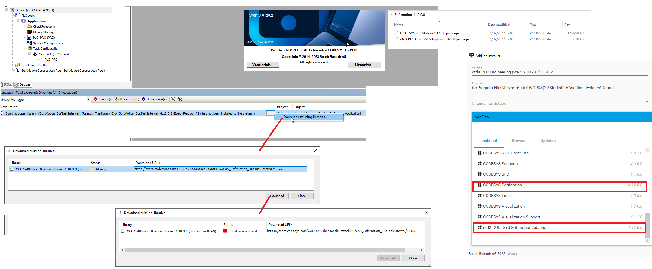

After enabling softmotion (4.12.0.0 package install) on a ctrlX WORKS V-0120.2 PLC project the message "Could not open library CXA_SoftMotion_BusTaskInterval 4.10.0.0 beacuase it has not been installed to the system" appears.  I tried to download from the subsequent dialogue but it failed.  Please see attached picture for more info.
Is this library necessary, if so how can I get a copy?

Best reply by bostroemc
The library should already be installed.  In the Library Manager, select Placeholders and map the library manually:
