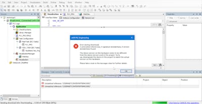

Is it possible to upload PLC webvisu project into CtrlX core virtual and open webvisu in CtrlX virtual?
I get an error when downloading to my CtrlX virtual.

The error tells you that there are firmware functions missing on the ctrlX CORE. So probably you are using a feature, that is not implemented yet. Which version of the PLC app and ctrlX WORKS are you using?
See this thread for information about the alarm handling.
Please have a look to this thread for information what is needed to use the CodeSys WebVisu.
