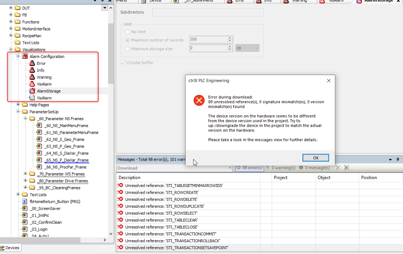

We are having unresolved reference error when try to use the alarm in Indralogic. This works fine while in simulation, but the unresolved error shows up when downloading to the Core. Indralogic and app 1.12.2
Found this codesys forum, which similar errors. Loaded Storage library, same error
https://forge.codesys.com/forge/talk/Engineering/thread/957ece9cae/
Please let us know how to fix it
Ulises
The error tells you that the functions used in your PLC project are missing in the runtime on the ctrlX CORE. CoDeSys Alarm Configuration is at the moment not part of the ctrlX PLC App. This is planned for RM22.07 coming up end of July.
