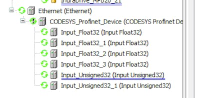

For this, I have added the add-on Profinet Device 4.2.1.0, and as you can see in the following picture I have added the Ethernet device and the Codesys Profinet Device. To the Codesys profinet device, I have added different input and output modules that will be activated or displayed from the external PLC to the ctrlX CORE.

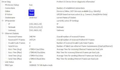

As you can see in the following image, I have a connection with the PLC S7-1200 but this connection after a while goes to error and automatically reconnects.
What could be the cause of the connection between the two devices being disconnected?

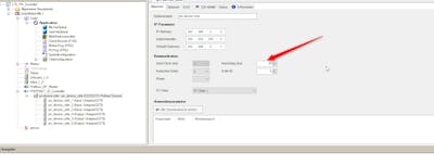

please increase the watchdog e.g. to 20 for the device at the PROFINET Master. Then it should work with 1ms cycle time at ctrlX CORE too. I don't know how to set it at S7 PN controller, but I added a screenshot of IndraWorks. If there are still some errors you should increase the value once again.
kind regards
