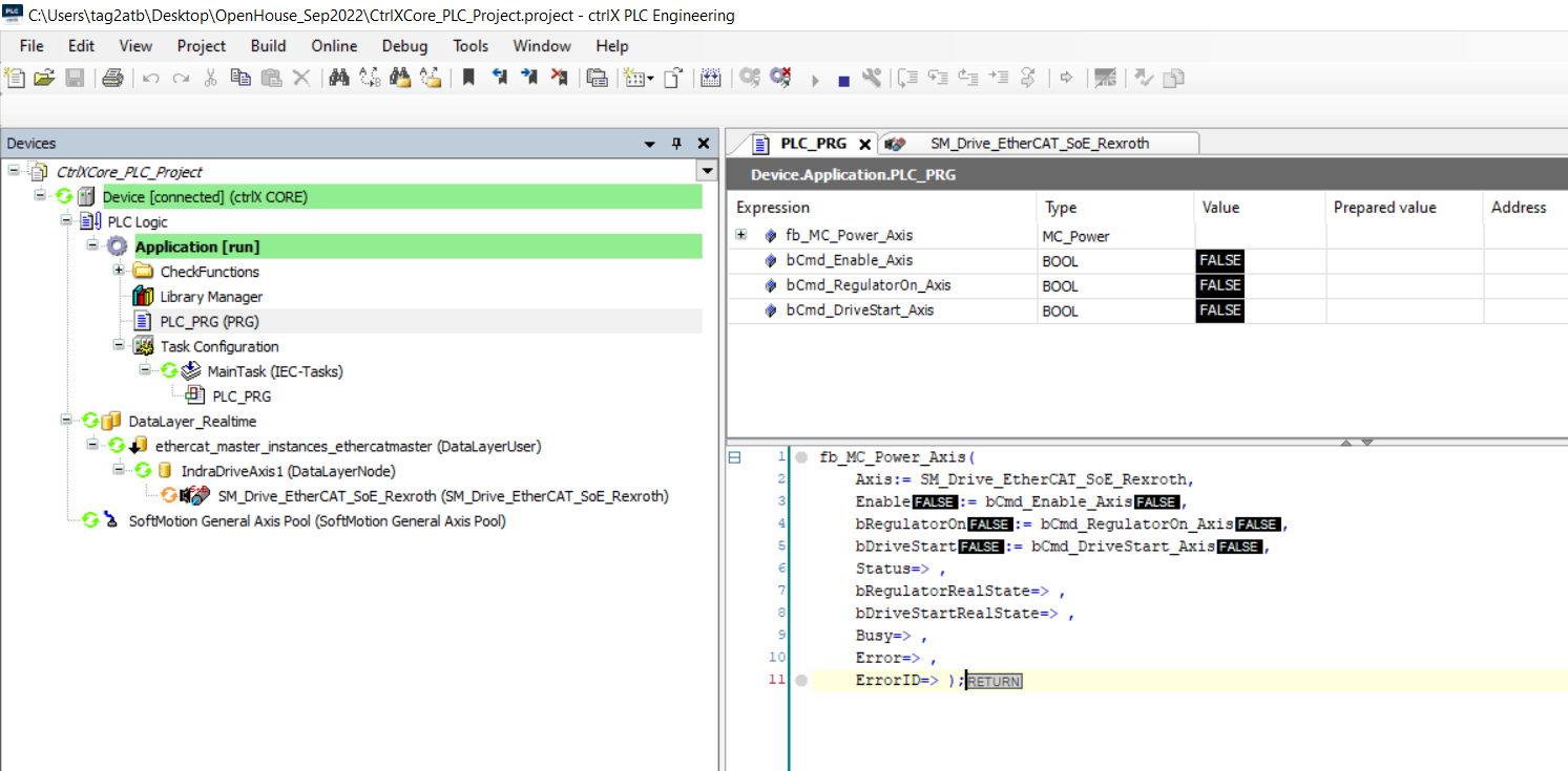

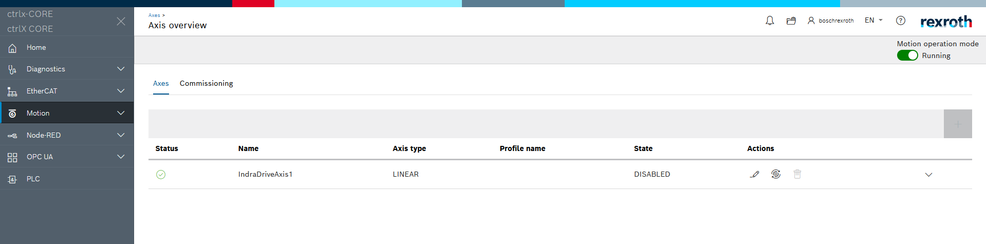

I was able to configure the axis and the EtherCat Master at the CtrlX Works IO, as well as configuring the SoftMotion at the CtrlX Works PLC. However, it does not look like the PLC is in charge of the axis, after booting, the CtrlX-Core switches the axis from Init to OP (no problem), but I still can not PowerOn the axis using the SM3_Basic.MC_Power function block.

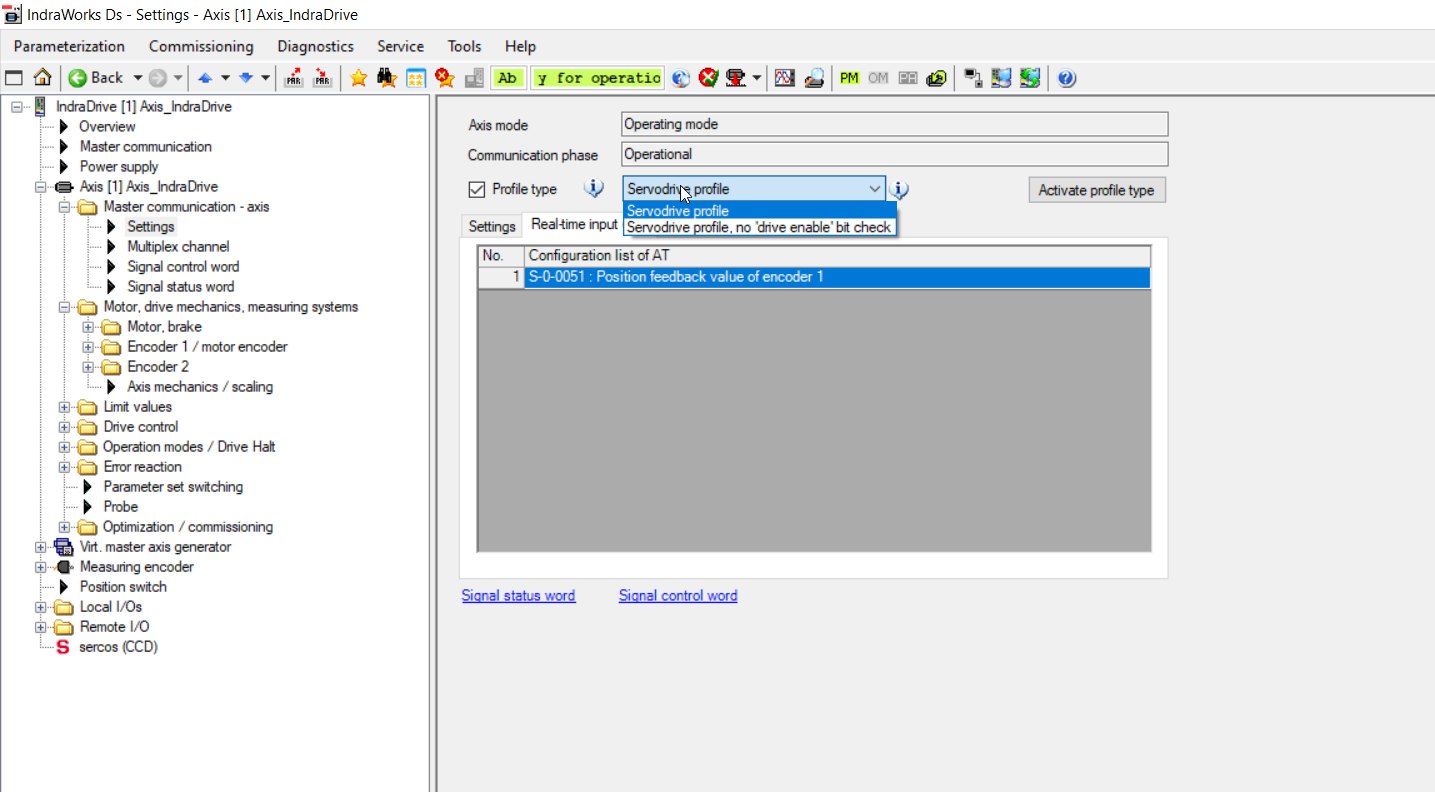

I have tried to use the Drive as ServoDrive Profile and ServoDrive Profile No DriveEnable bit check, but none worked out. I tried to add the S-0-0134 and S-0-0135 in the AT/MDT lists but those parameters are deleted when the drive reaches OM.

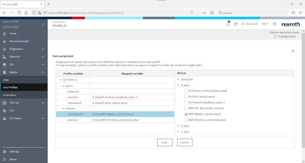

For first commissioning we also have a how to video that shows the usage of ctrlX MOTION in combination with the ctrlX PLC. See this page for reference.
I did not do any mapping in the PLC. This would also lead to conflicts because PLC and MOTION would both try to command the drive.
The connection was established via the "Axis Profiles" in the ctrlX MOTION app and commanding all as well as position is done via this.
ctrlX CORE WebUI Axis Profiles mapping
