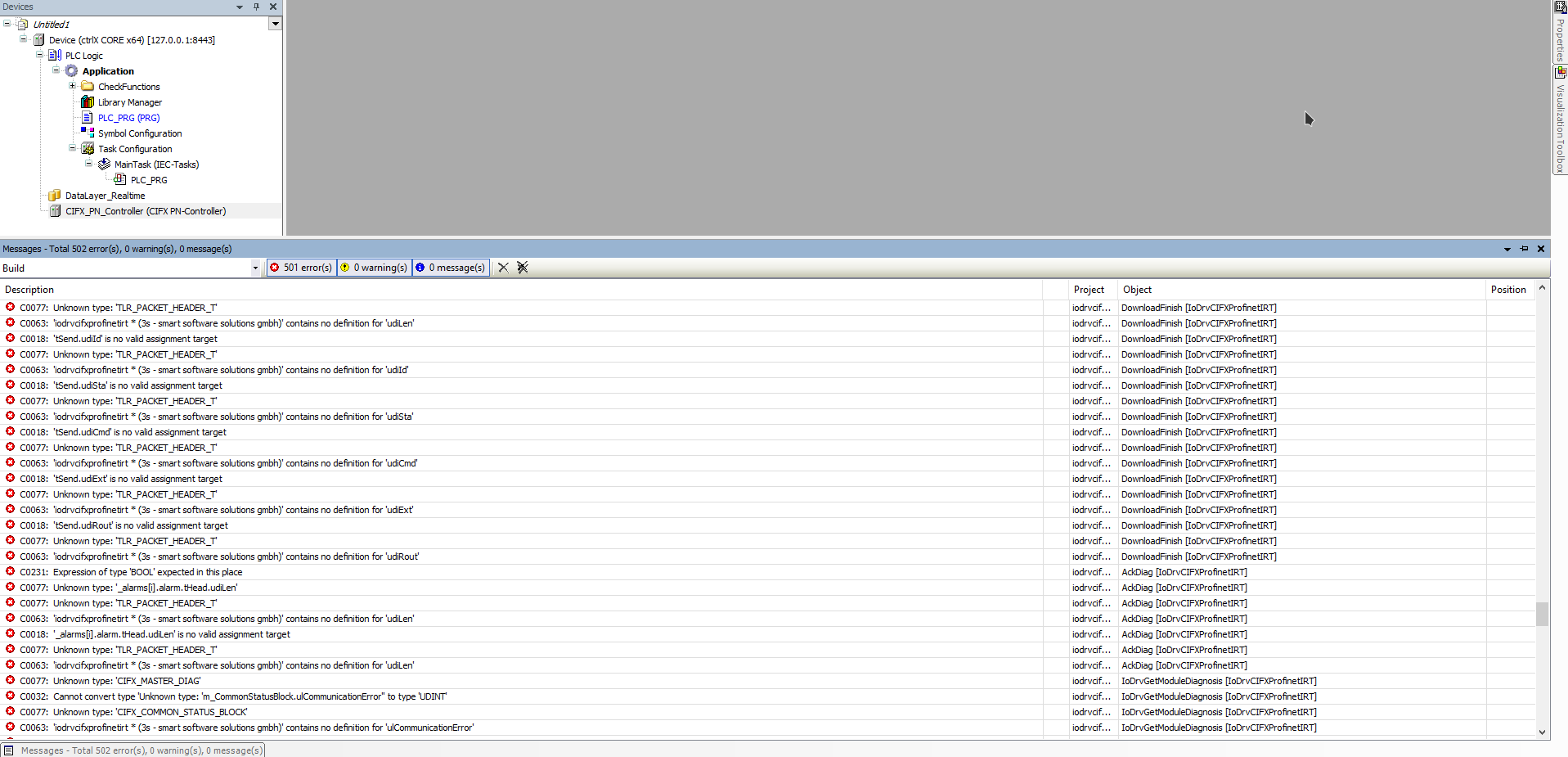

When using Profinet Controller 4.3.1.0 with PLC App 1.20.4 (both latest release) there are many errors cause by unknown type.
At least one library if not more are unable to be resolved causing 502 errors when trying to compile. Find at screenshot of a section of the CodeSys message window.

Hi Chris,
you are using the wrong PROFINET controller (CIFX). Please check the manual we provide!
