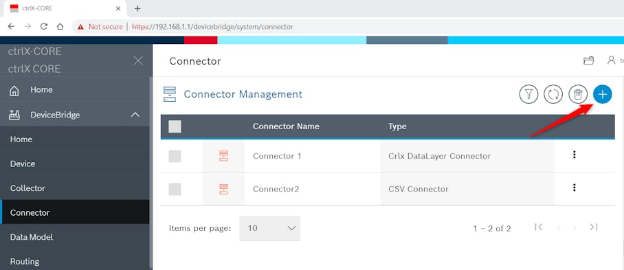

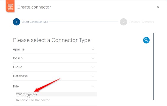

Add Collector of type File - CSV Connector

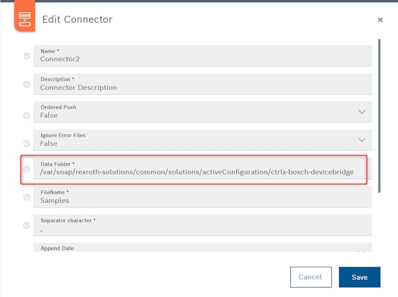

Specify destination folder
DataFolder is the path where the .csv will be stored using FileName with date/time appended. Here we are storing in the root folder for DeviceBridge app data. Create sub-folder structure using WinSCP if desired (see last step).
 /var/snap/rexroth-solutions/common/solutions/activeConfiguration/ctrlx-bosch-devicebridge

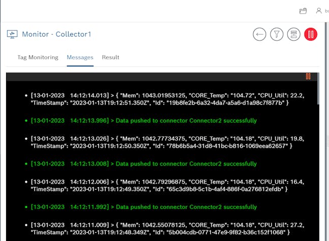

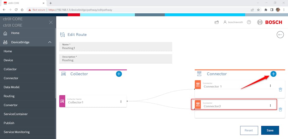

Add Connector to a Route
Publish (or test in Connector dialog) to verify successful transmission

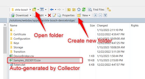

Retrieve .csv file

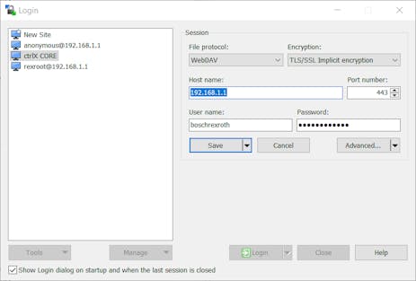

Use WinSCP with WebDAV protocol to connect to ctrlX CORE
This is a special path for accessing app data via WebDAV. This path differs from the destination path specified in the Collector setup, nevertheless it is mirrored to this location. You can also use WinSCP to create subfolders in this area to organize .csv storage.
/solutions/webdav/appdata/ctrlx-bosch-devicebridge
