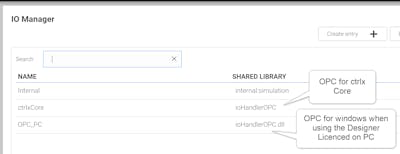

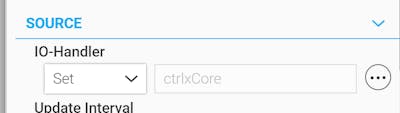

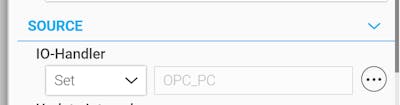

When developping locally on PC the IO Manager needs to use ioHandlerOPC.dll this allows to browse and create variables , however when comes the time to publish the app on the ctrlX Core the ioHandlerOPC  must be used.
Is there a way to change the OPC source without editing or recreating all variables ?
IO handler config when working on PC
IO Handler config for publishing on the ctrlX core

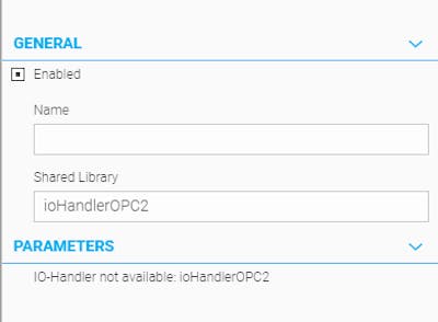

if the DLL would not be found on Windows you'd simply not be able to see any of those fields in the IO Handler configuration when selecting the corresponding IO Handler. So we can rule out that this is an issue here on Windows as it would simply show "IO Handler not available" just like when you'd rename that entry:
