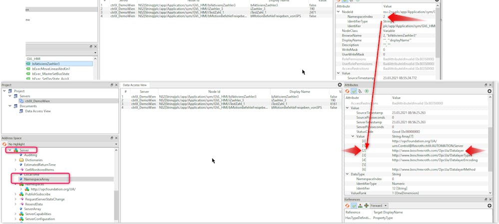

I think you checked with an OPC-UA client e.g. "Unified Automation UaExpert" the namespace ?
In my example:
Then your namespace should be the right.
At ctrlX CORE virtual I use port forwarding with adjustments:ย 8022:22,8443:443,8740:11740,4840:4840,10123:10123
