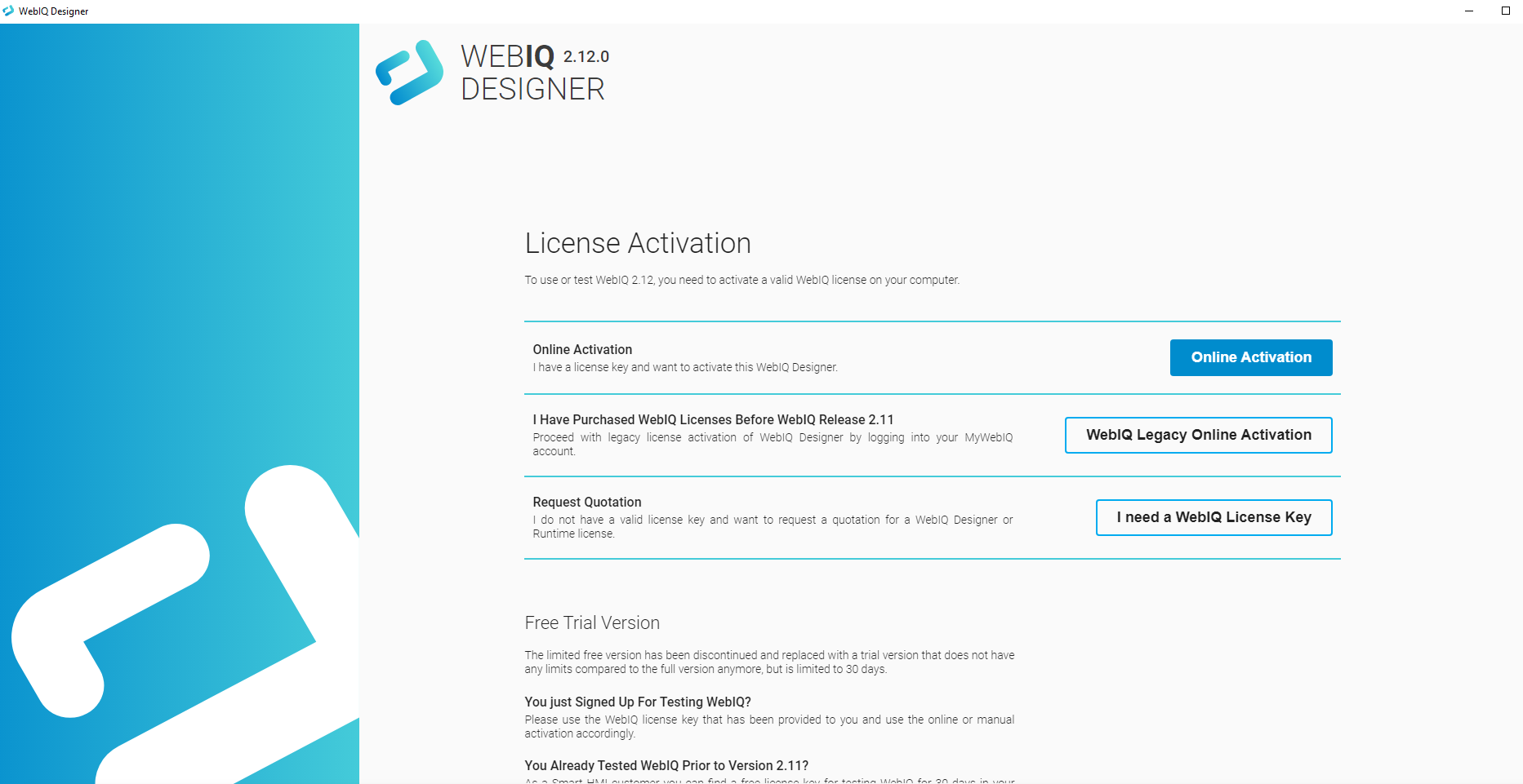

I purchased a 1K license for CtrlX, the license has been activated on CtrlxCORE and has an unlimited expiration date.
I downloaded the Designer from the Collaboration Room, installed it and created the shortcut with the dedicated software.
Shortcut parameters: IP Address 192.168.1.1, Port 10123.
"C:\Program Files\WebIQ\Designer\webiq-designer.exe" --ws-host=192.168.1.1 --ws-port=10123 --user-data=webiq-designer192.168.1.1-10123
Starting the Designer via the shortcut, after logging in, a page for requesting license activation opens (I attach image).
The date-time of the CtrlX is ok.
I tried to uninstall and reinstall the app on CtrlX; I also tried reinstalling the Designer on PC.
Can you help me understand the problem and solve it?
Best reply by HmiGuide
When you download the WebIQ software from Rexroth store, there is a Readme file.ย ย
Read this file, to get informed on the different licenses types (license for ctrlX or PC) and how to install and use them.
