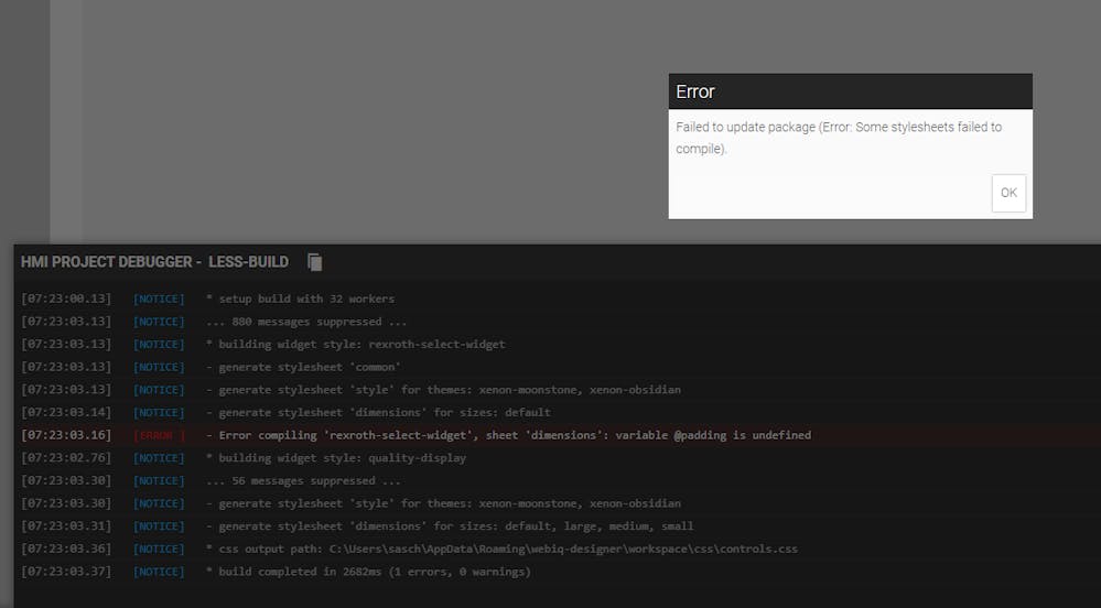

Other than that I could not update the project because I do not have the used custom widget and the custom widget in the HMI contains an error where a variable is used in the LESS files that has not been defined:
I was able to fix this by defining it in less/custom/controls/rexroth-select-widget/sizes/default.json of the custom widget.

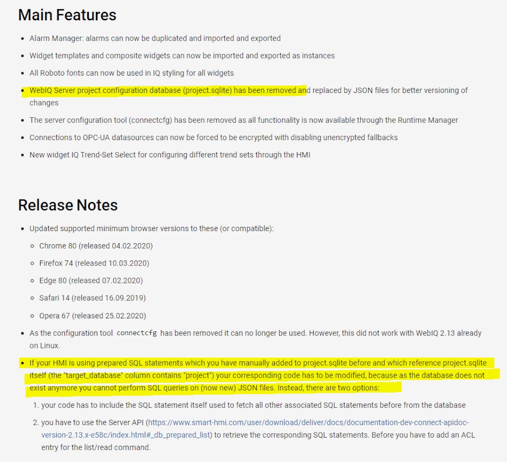

When it comes to the database - you are using WebIQ Server 2.14.3 - the changelog for WebIQ 2.14 shows this:

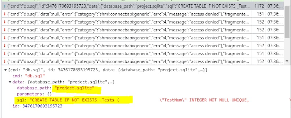

Furthermore, project.sqlite was a system database. You however used the database for creating custom tables inside:
This is unsupported and done at your own risk. Simply creating your own SQLite database and executing your queries on this file would have been the correct way to do this as these will remain untouched.
This is also the solution for your request.
