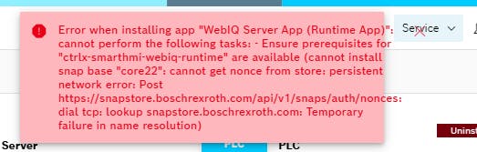

Currently my X3 has system image 1.20.13 and WebIQ server 2.15.7
My associate has sent me a program to test that was written with 2.15.10. I can't download this version from the web as we have already moved on to 2.16.2. I can't load the 2.16.2 app onto my X3 as I get the following error.
Does that mean I need a ctrlX 2.x.x OS version?
