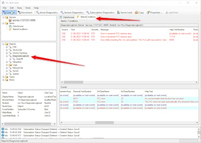

  • I want to connect WebIQ and IndraMotion MTX system via OPC.
  • Smaple screenshot from UA Test Client connected with MTX and with subcribed alarms item.

WebIQ currently does not provide built-in support for OPC-UA alarms. You can however use the built-in alarm management to observe item changes and raise alarms.ย
