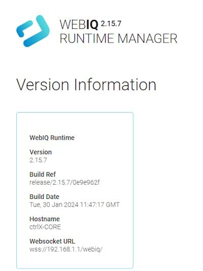

I updated my web iq designer and runtame manager to 2.15.7. then open the HMI project in the webiq designer and go to manage=> package manager => visual 2.15.7
how can we further update?

You can only install WebIQ 2.15.8 on ctrlX through official channels. If it is not available there you have to wait.
You cannot downgrade HMIs so it's best to restore an older version from backup/VCS and use that until WebIQ 2.15.8 is available for ctrlX. I can't give you any date on this because we have handed over version 2.15.8 on the day we released that version to Bosch Rexroth - maybe they can give more information on the release date.
