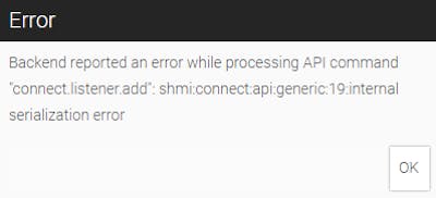

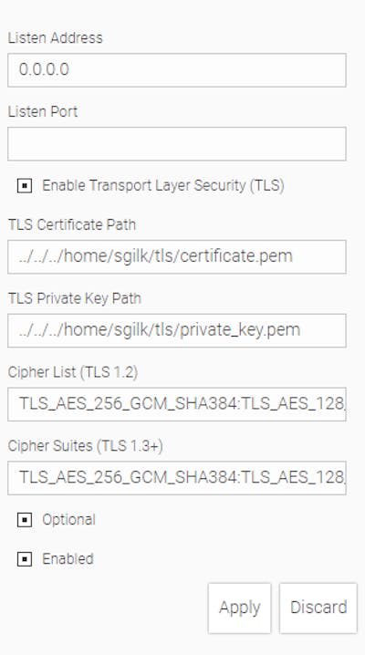

I am trying to add a listener with TLS enabled to the Web IQ runtime on my ctrlX core. I generated the certificate and private key via SSH into the core. I recieve the error below when applying this configuration in Web IQ designer. This is not listed in their API documentation.
Is there a documented method of doing this correctly somewhere?
