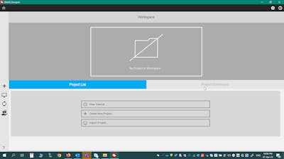

Hello
I have a 30 day trial web IQ deisgner License
Where do i enter this license and activate??
I dont find any option to activate trial license!
Thanks and Regards
SAM
Hello
Thanks and Regards
SAM
Hello Sam,
you are using WebIQ version < 2.11. With that you do not need a valid license as it is limited to 30 items and can be used indefintely without any license.
Beginning with WebIQ 2.11 the free but limited version has been discontinued and replaced with a 30-day trial license which has no other limitations when compared to the full license.
Your license key is only required and can only be used with WebIQ >= 2.11.
