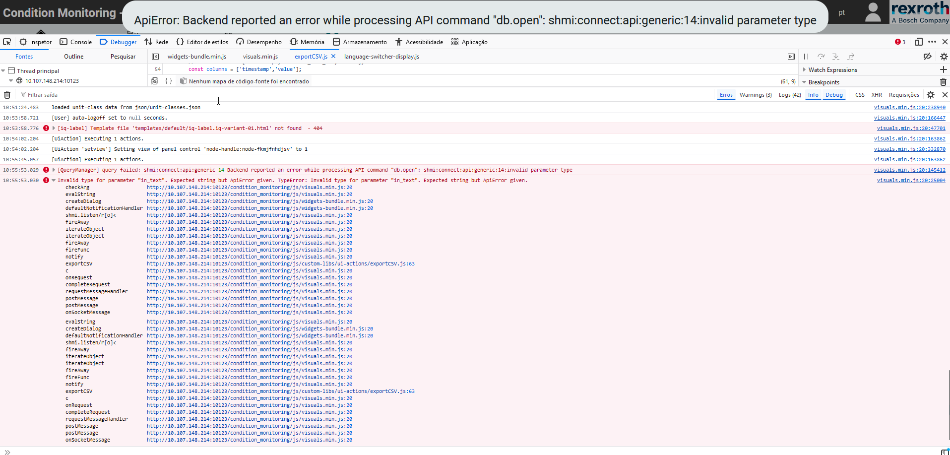

This was cool, but I want to improve the code to retrieve the data points in a time interval that a specific event occurred (e.g. pressure raise, temperature outside limits, etc), so that a specialist can download and analyze offline. Then, the current values are not sufficient for me. I want the past values. I'm trying to use the queryDirect() method of QueryManager that I read in the documentation. However, I'm getting an error while trying to open the database (see the screenshot). I'm struggling to fix the code. I hope someone in the community can help me.
