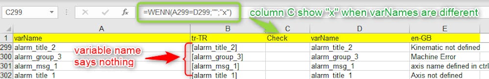

How can I use the export file?
Question:
I added a new language and exported it. The file (csv and json) only contains the localization variables, but I need the texts of my default language to be able to translate it.
Workaround:
In WebIQ 1.10 there is no way to create a export file with multiple languages. But you can do it by yourself.
  • Export a csv file with the 1st language (containing your texts)
  • Export a csv file with the 2nd language (which should be translated)
  • Open both files in Excel
  • Copy content of 1st file into 2nd file into columns D+E (the order of the keywords is identical)
  • Translate everything
  • Remove all columns except A + B
  • Save csv file
  • Import csv file into WebIQ
  • Use Excel function =IF(A1=D1;” ”;”x”)to verify if varNames are identical
