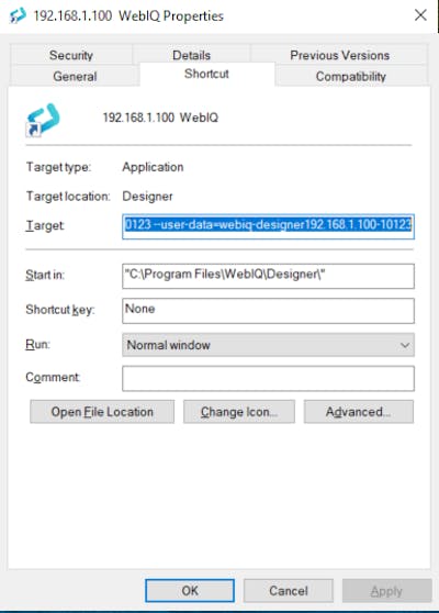

Hello BernhardKausler ,
The WebIQ designer shortcut needs to have some flags applied to the target. Here is an example for the target ctrlX CORE WebIQ runtime server at 192.168.1.100:10123. The flags must be updated if the runtime port or IP address are changed.
The flags after the executable path are what need to be added.
"C:\Program Files\WebIQ\Designer\webiq-designer.exe"  --ws-host=192.168.1.100 --ws-port=10123 --user-data=webiq-designer192.168.1.100-10123
