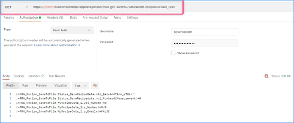

With a REST client, t.e. Postman, you could test the download command (GET...file):
t.e.: https://192.168.1.1/solutions/webdav/appdata/plc/run/linux-gcc-aarch64/data/Daten.RecipeDataSave_1.csv

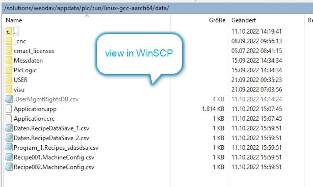

With WinSCP (WebDAV protocol) my directory looks like this:

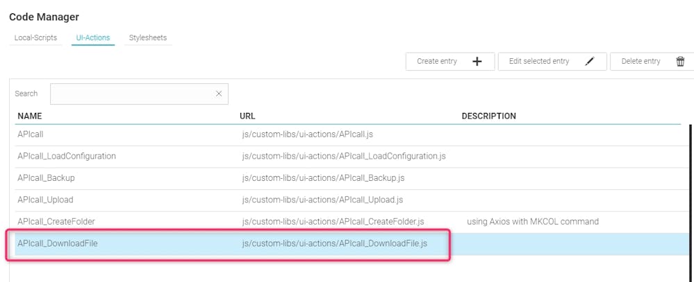

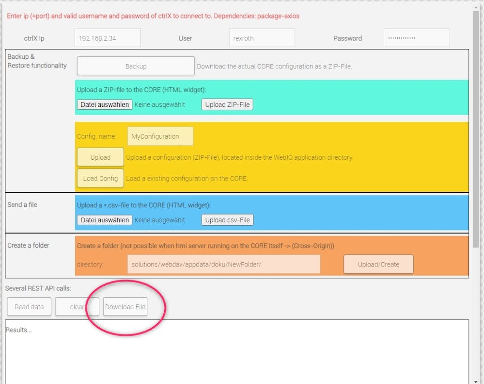

And within WebIQ you could have a look to this button or better to the UI-actions "APIcall_DownloadFile":
WebIQ_Demo-RestAPI_20221024.zip
