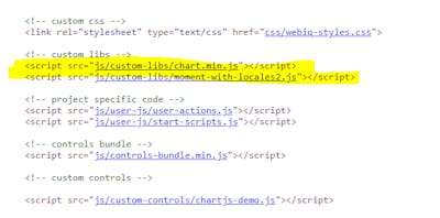

All libraries added as packages are automatically added to the HTML code (just inspect the HTML code of your HMI in your browser and you will see script tags with the includes of your libraries there) - it's essentially just a normal website (that has been enriched with functionality) as any web HMI is:
