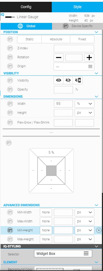

I have a problem in the display of the values, when I set the values in the editor they are displayed correctly (Photo 1)

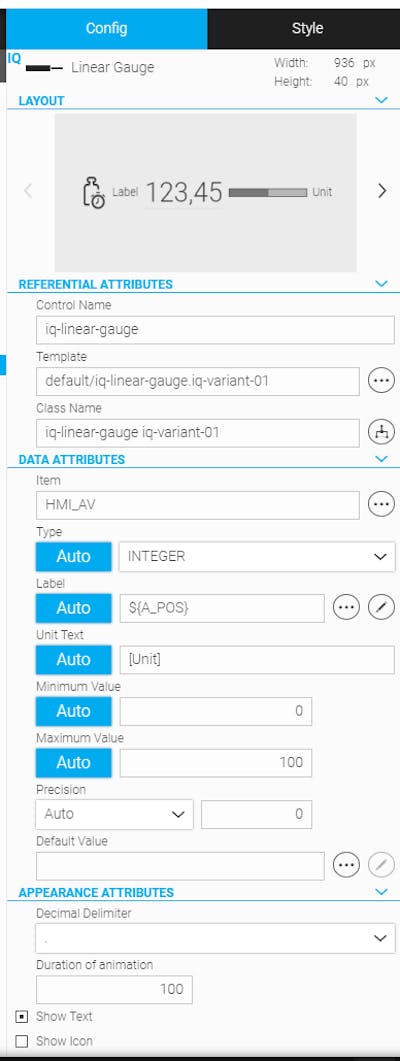

but when I launch the simulation the Item base line appears vertically (Photo 2)
as a line that increases in thickness and not in length. I would like the classic display, i.e. the line that colours from left to right.
Can anyone help me? Photo 3 Widget settings.
